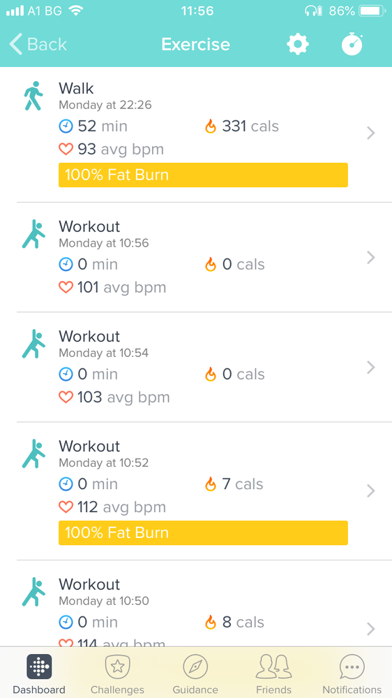

Hello, I have a problem with my workout exercises. It does not display the durations. Any ideas, thank you.

Best AnswerHello, I am tracking my workouts via my Fitbit Charge 2. The watch displays the durations but the app does not. About force quitting and logging in and out - I have not tried those. I do have picture to illustrate the situation. Thank You for Your help, Sir.
After sinchronization the durations are at zero...

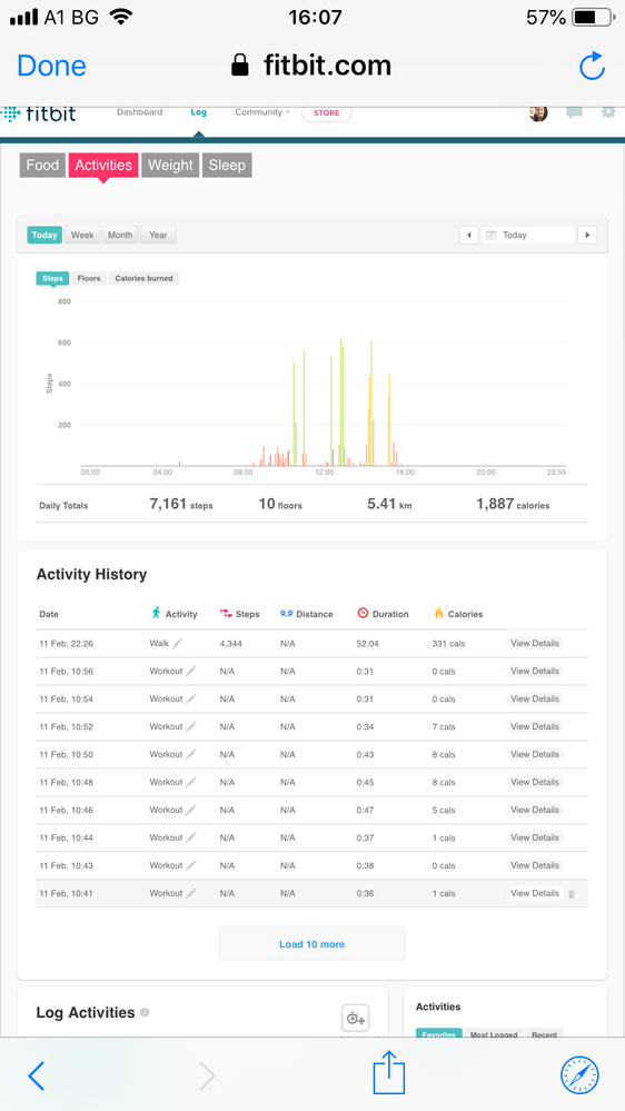

Best AnswerHello, I’ve tried force quitting and relog with the app and the result remains unchanged. However, quoriously, I found out that the online dashbourd You showed me is displyaing my durations. Take a look.Online dashboard

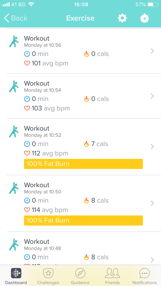

My iOS app dashboard
Best Answer@WOLFMX -- can you describe the steps you take to start and then finish a workout on your CH2?
From your activity record, it looks like you are starting a workout, and then a couple of minutes later trying to start one again, and then a couple of minutes later trying ... and again ... and again ... :-). It seems like you are missing something in starting or stopping the exercise, or maybe both starting and stopping it repeatedly by accident. Here are the steps (see link, or what I have copied below) you should be going through to start and complete a workout:
I hope that helps you figure out what it going on. Let use know.
