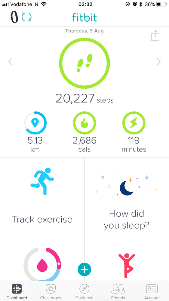

There is an issue with the syncing of kms covered in a day. Inspite of waking and jogging for 2 hours or more the kms covered shows only 4-5 kms instead of 18-20 kms.
Hello @SapnaB, I hope you're doing well, it's nice to see you around. ![]()
Thanks for bringing this to my attention. Tell me, which tracker are you currently using? Is your tracker auto-detecting your exercise or are you starting an exercise from it? Would it be possible for you to reply to me with screenshots of your Dashboard where the distance is showing and screenshots from your exercises? That will be very helpful for me to check this further.
Any other details and screenshots will be helpful as well, thanks for your patience and understanding. I'll be waiting to hear from you.

Hi Marco,

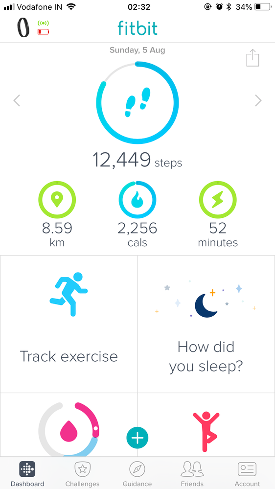

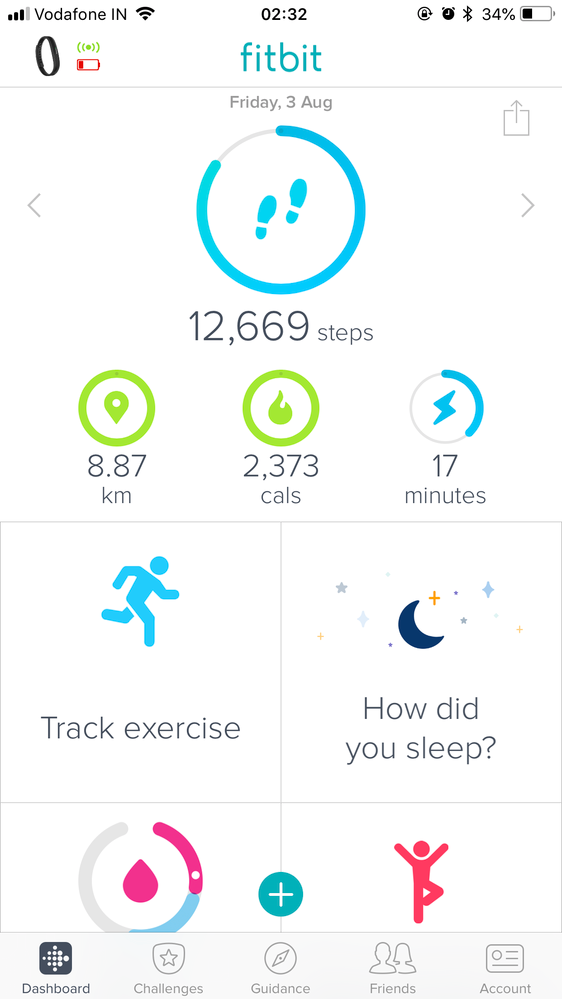

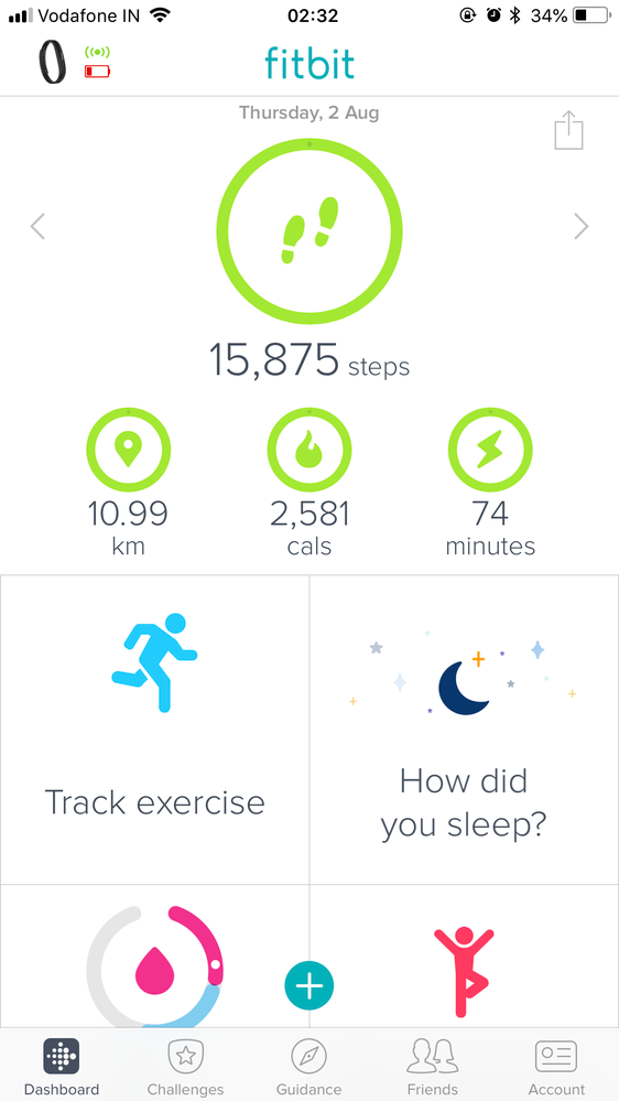

Many thanks for your reply. I’m using the Flex 2 and the sync problem started since last few days. Upto the first week of August the sync was working well.
i have uninstalled and reinstalled the app on my phone as well as logged in and out too the app but to no avail. Please see attached several screen shots from pre and post sync issues so that you get a clear understanding of the issue.
Will look forward to your revert.
Thanks.

Best AnswerDear Marco,
I hope you’re doing well. I was wondering if you have managed to resolve this issue that I’m facing? My Fitbit watch still isn’t syncing in the distance I walk accurately as a result of which I was disqualified from a steps challenge in my organisation. The steps covered by me don’t match the kms covered by me and therefore my steps weren’t taken into account!
Thanks.
Hello @SapnaB, I hope you're doing well, thanks for taking the time to reply. ![]()
I appreciate your participation in the Forums and for coming back to us. At this moment I still don't have an update about this issue, however I would like to suggest you to check your stride length and adjust it in case you need it, this might help you get a better distance reading in the Fitbit app. Fitbit devices calculate distance by multiplying your walking steps by your walking stride length and multiplying your running steps by your running stride length. By default, we calculate your stride length using your height and sex. As your distance measurement seems inaccurate, follow the steps below to calculate your stride length and then add it to your Fitbit account.
To measure your walking stride length:
Your running stride can be calculated the same way if you run instead of walk. Now, in order to change it in the Fitbit app:
I hope this can be helpful, give it a try and let me know the outcome!
Best AnswerMany thanks for your reply. I reset my strides distance and the kms tracking is back to normal.
Hello @SapnaB, I hope you're doing well, thanks for taking the time to reply. I'm very glad to know your issue has been resolved after resetting your stride length. In case you have some spare time, I would like to invite you to visit our Discussions board where you will find great tips and encouragement from other members and if there's anything else I can do for you, please keep me posted!
