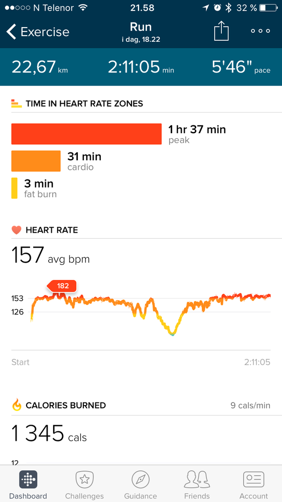

Started a run from my Blaze this morning and during the run I got detailed info on distance, speed and average time. When ending the run at 6,7 km the Blaze showed the detailed screen with all km splits, elevation, hr, distance. Everything.
Then synced the run to my fitbit app and all the details disappeared. I still get distance, time, pace and HR, but no map, no splits, no elevation, no nothing.

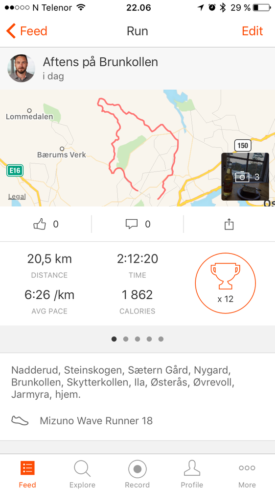

At the same time as I stated the run from my Blaze I started a strava app run. After just a few km there was a difference on them length by 300+ meters. After 10 km the Blace reported 11km and strava had 10km. At the end of the run strava reported 20,5km while the Blaze reported 22,69km.

After syncing to the phone a exercise reporting time, km, and pulse appeared. No map, no laps.
Some 10min later a new exercise reporting the same length as strava but with 15min additional total time.

When connected to the phones GPS I guess that my stride length has nothing to do with the length of the excessive - and why does the Fitbit app create two different exercises with different time and length from the same run?
