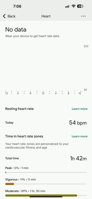

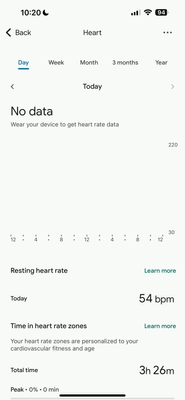

I have worn my Versa 4 since 05/28/25, and have recorded over 236,000 steps. All data syncs to my FitBit app on my iPhone, except for the hourly Heart Data Chart. How do I solve this issue?

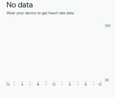

Thank you for the quick reply. I have done as you advised, but unfortunately it still states “Wear your device to get the heart rate data”.
After suffering a H/A in 10/06/24, followed up by 3 stents, my wife purchased this so as we can keep track of the heart data, as I am full tilt back into cardio and strength training. Hopefully we can get this to work. It’s great having all the secondary data, but the daily chart would really be nice.

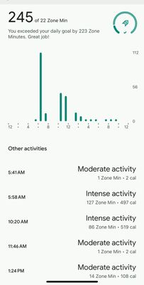

@TheTruth101 I don't have this bug on my iPhone, so I don't know why you have this issue. I flagged your post to get a moderator's attention. You can see your heart rate in a different tile. Tap on your Active Zone Minutes tile. I hope this graph is working for you. Both your screenshots list your time in your heart rate zones.

Thank you, Laurie. I have found all of the other tiles, and areas, that list the heart rate data, but this one, screenshot below, will show me the entire day at a glance. Thank you for tagging my post. Hopefully they have a fix. Appreciate your assistance.

@TheTruth101 Please tap on your Active Zone Minute tile (or icon if you have it in the top icons). There is a bar graph at the top. Scroll down to the graph. It shows the whole day, too.

Miss Laurie, yes I have that Zone Minutes graph, and it is working properly. Just need the Heart Data graph to work in the same manner.

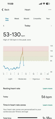

It’s an app issue with iPhone. Have to go into iPhone Settings, General, Time & Date, and toggle on 24-Hour.
Went back and checked the Heart Rate Data chart and it was displaying correctly!
