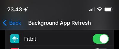

- Background App Refresh - Fitbit are ON
- Allow Location Access - Always - and Precise Location ON

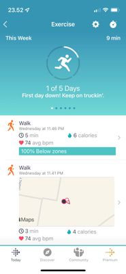

On top - app closed when tracking
On bottom - App open in the background
