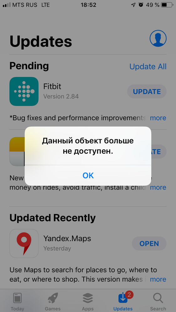

1) Starting from around 2.82 version time frame it looks like Fitbit App was removed from Russian App Store. Means, it's not possible to find it and install it. So the question: Could you return it back, you have grateful customers in Russia that really like Fitbit ecosystem (Fitbit Charge 2 + Fitbit Aria 2 in my case), so hope you can support us.
2) I have a separate Apple ID linked to US App Store. When I try to update Fitbit App using this Apple ID it tells me that "The object is not available anymore" (my translation to English, since the message is given in Russian), so this way of update Fitbit App doesn't work for me either. Could you advise me what should I do it order to get updated version

Thanks a lot for your attention. Here are a couple of snapshots, hope I got you correctly on what you need. What I see when trying to update
Fitbit App as proof that I'm in US App Store (app is not seen in Russian App Store anymore)

Hi,
I tried your approach but unfortunately it still does not work for me. The same "The object does't exist anymore" (in Russian) message. The authorization scheme looked a bit suspicious for me when I tried to do it as you asked. Actually I tried it 2 different ways, first as you said Log Out -> Restart -> Log In with US App ID -> Try to update. The result is the message above.
2nd way was Log Out -> Restart -> Update (Select "Update with existing App ID" in pop up window). Here it says to you that you need to do additional authentication in Settings, you switch there but even during your entering User ID/password the pop-up message "The object does't exist anymore" (in Russian) appears.

The problem was solved. You need to go to your Apple ID settings - iTunes and change country from Russia to US. Input all necessary contact information (Address, Telephon, ZIP etc.). After that go to App Store. You will come to US App Store. Load Fitbit to your smartphone. Go to Apple ID again and change country from US to Russia.
