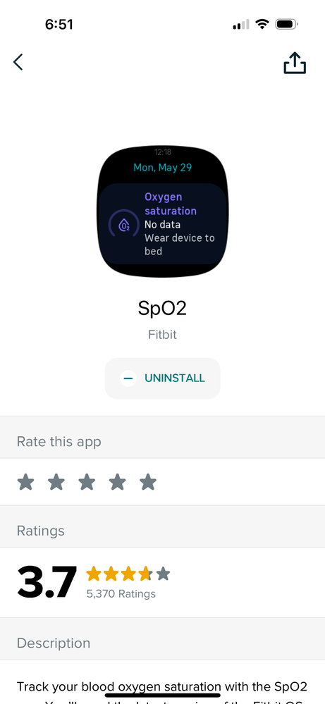

Hi - purchased a replacement  sense2 - lost my old clock face and selected a new sp02 one - installed but it says sp02 app not installed- when I try it says not available- but the watchface says it’s compatible with sense2 !
I seem to have a very limited amount of free clock faces and none to purchase ??
I have disconnected blue tooth and restarted and I have force stopped the fit bit app and re opened but no more clocks or sp02 app that will install ? Please help

This may be an issue with the latest update.  I also have a Sense 2 and after the latest update the Health Metrics SpO2 detail says I need to install the app even though it's installed and tracking data.  I've uninstalled/reinstalled the SpO2 app as well as uninstalling/reinstalling the Fitbit  app and still get the same messages.  Unfortunately, every update seems to break something that worked perfectly fine.
I received the app update today (v4.40), noticing that the health metrics display format has changed. All metrics are presented except for SpO2 which states 'No data App install needed'. After clicking on that, then 'Install the SpO2 app' leads to the install page which states 'not available'. Clicking on that button produces the message 'This app is not compatible with your fitbit device'.

Thanks for bringing this to our attention and sharing the steps that you've tried. @mhouse I also appreciate you for the screenshots.
I'm writing to inform you that we have escalated this issue to our team so they can identify a solution as soon as possible. I'm sorry for any inconvenience this situation may have caused you. Please be assured that I will keep you informed of any updates as soon as they're available.
