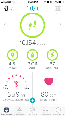

I should have done this before - what the image below shows is that my Alta HR is not sending my currently heart rate to my iOS app. It does show my latest calculated resting heart rate of 69, but no real time heart rate information.
Is that what you are seeing, or are you seeing this:
The second image does not show my resting heart rate because it replaces that portion of the tile with what heart rate zone I am in; either "Fat burn", "Cardio" or "Peak".
But now - if I can get my heart rate below fat burn, or less than 50% of my 155 bpm max heart rate (I'm 65 years old)
ooooommmmm 😉
I get both - real time heart rate and latest calculated resting heart rate.
Are we getting closer?

I see the first image.
Best Answer01-14-2018 21:00
01-14-2018 21:00
Ok. That tells me that the device is not sending the realtime heart rate to your app, or the app isn't accepting it.
And after typing a bunch of stuff, I re-read your original post where you said you checked the settings, reset the device, re-installed the app, etc.
