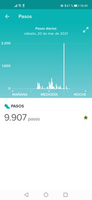

Thank you for your answer. None of the causes you mention seems to be the problem here. I haven't added any activities, I just let the band detect the exercise automatically, and I just have one device.
Since I started this query, the problem has persisted, showing more steps than it should every time I sync, although it only saved the changes once more from one day to another, adding around 2000 steps and some calories that weren't real.
As an example, here you have what the app is showing today, just in the morning. Everything is right except for the steps, that according to the band would be around 1900 steps.

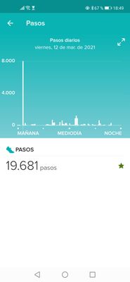

Here are a couple of examples of what the app shows when it adds steps that are not real and they're saved

@Car81 Thank you for the screenshots shared and the details mentioned.
The best way to get help for this problem is to chat with us online or give us a call. Click here to get connected.
