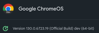

I'm using a pixelwatch 2 and a Motorola phone running Android 11. Within the Fitbit app, the ECG download on my phone has been working fine until a week or so ago. Now it just spins and the download never completes. Looking at older posts with the same trouble, I've repeatedly attempted to clear the cache, uninstall the app, reboot my phone, reinstall the app, with no success. The trouble may have started with Fitbit version:
Also -
I have two Chromebooks running the same ChromeOS version and the same Fitbit version but an older version than the one on my phone, and ECG download works fine on both:
... and Fitbit version:
For now I'm holding off updating the Fitbit app on my chromebooks for fear that ECG download will break there as well.
If there's a remedy for my phone troubles please share. I have a feeling that in the 4.26.1... update, something got screwed up in the validation of permissions for file access and the download is not proceeding because of that (the update broke compatability with Android 11). My wife has a pixel7 running Android 13. I can test the download there using the same Fitbit app version. When I do this, I'll add that result.

I'm now running the following version on my phone (Android 11) and my two Chromebooks, both of which are actibvely receiving ChromeOS updates:
No change in behaviour. Downloads still don't work (hang) on my phone but work fine on my Chromebooks. Seems to still be perhaps an Android 11 compatability issue (is one theory).

A clarification - for my Chrombooks where the ECG download is working fine, I have updated both of them with the latest Fitbit version and the ECG download continues to work fine (I'm running latest ChromeOS + latest Fitbit revision). My current theory remains that starting at Fitbit 4.26 something changed that broke the ECG download for Android 11.
