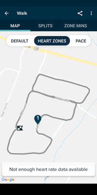

I just walked 1.25 miles and earned 26 zone minutes (cardio and fat burn), but the heart zone data on the map screen still says not enough heart rate data. The GPS is working correctly and my map is correct. So how can I earn zone minutes if there's not enough heart rate data??
I followed all your suggestions and the Bluetooth is on, the device synced. The 1.25 mile walk was accurately mapped. I earned active minutes  that indicated cardio and fat burn minutes. However, the Heart Rate Zones still says "not enough heart rate data". How can this be if I get active minutes?

If after performing this troubleshooting, the workouts are still showing this, please attach a screenshot to your next reply.
Hope this helps.
Ok did what you suggested and got the same result. Attached is the screenshot.
 I received 17 active minutes.
