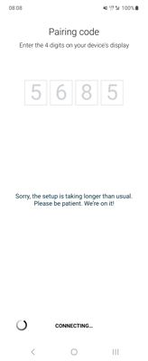

I keep getting stuck here...
Nevermind!! Took an hour of trying to sync and all seems to be working, for now!
