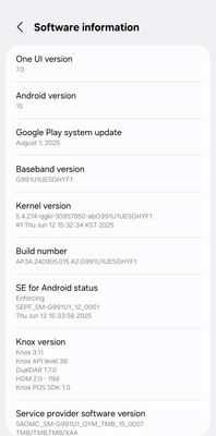

I'm having this exact issue on a Galaxy S21 running one UI Version 7.0 - Android Version 15. The app will either freeze with the please wait prompt, reset to the main page or crash / close all together when attempting to edit and update the food plan.
