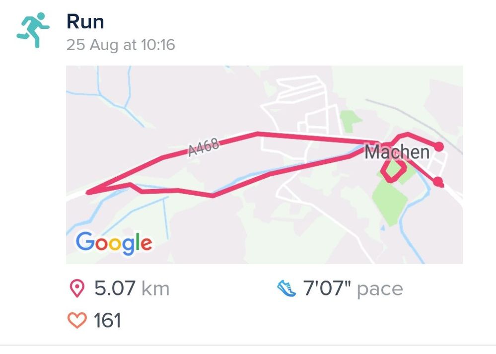

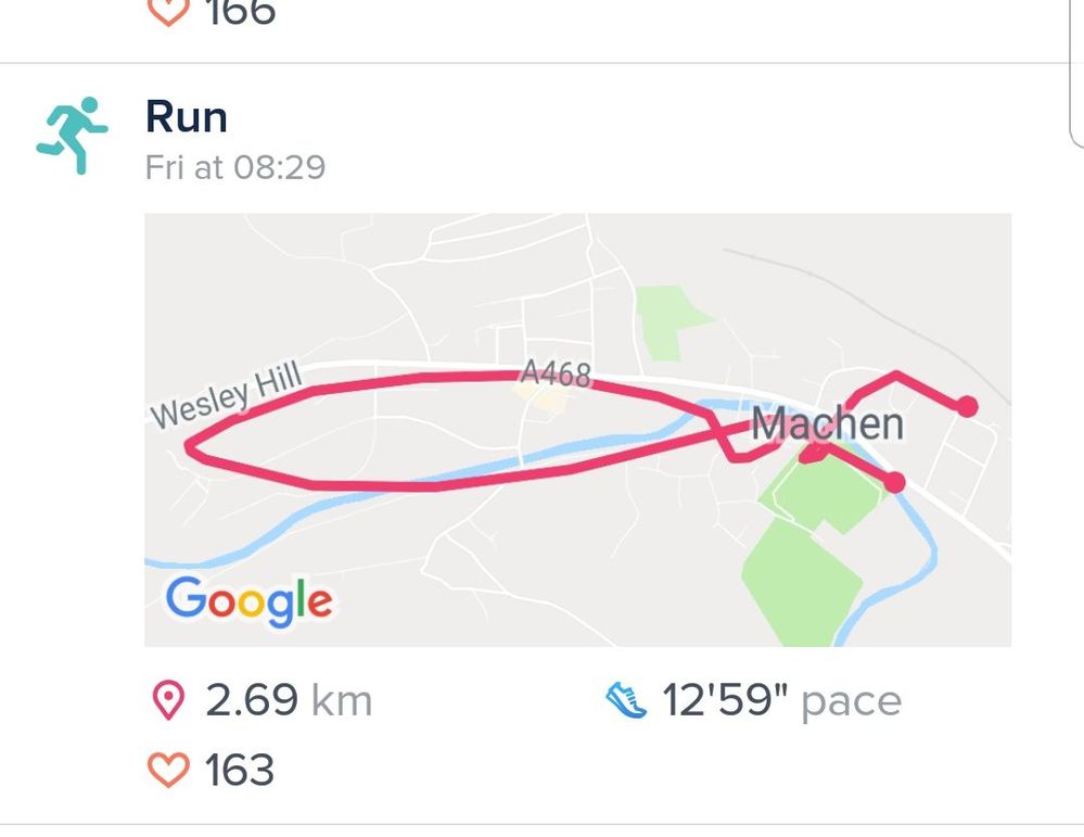

I've had my fitbit charge 2 for just over a year and up til this week has worked fine.
The last two runs I have done I have noticed that the GPS doesn't seem to be running well. For example, my usual 5k route came up as only 2.13k.
You can tell because the map looks like a loop rather than the actual road I followed. The same happened today despite the signal being 'Good' and in the green before I set off!
I don't think it's due to trees or mountains ect.as I've been doing the same route for months with no probs.
Any suggestions how to fix?

Thank you for your reply!
I've attached two photos of my regular 5k route. You can see the difference in shape and the difference in distance despite it being the same route.
I am using a Samsung galaxy s8.

Result! After my runs were still not logging correctly with the fitbit app I went to try Runkeeper. Before I started it prompted me to check my battery settings as this can affect the GPS.
My battery was in medium power saving mode so I switched it to normal and hey presto the GPS is now tracking correctly!
