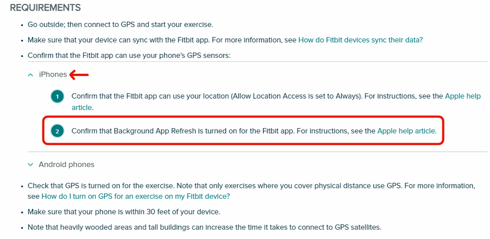

also a bug on the website
Under phone connected GPS, requirements, Andriod Phones number 2
"Confirm that background app refresh is turned on for the fitbit app"
The "See the google help article" links to an apple page, not a andriod / google page

The link is definetly broken for me
This link here goes to https://support.apple.com/en-us/HT202070

Hello, @pomtom44.
I think that you're referring to this part of the article:
If that's the case, the link will take you to the Apple Support page because these instructions are for iPhone users.

hi @BraulioFitbit
No......
I have a android phone.
I am under the android section (as shown in the screenshot)
That link, which I have highlighted in the screenshot goes to the apple link
