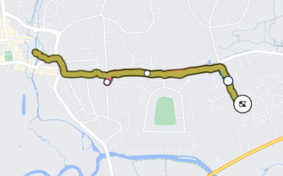

Just took my Pixel Watch 2 LTE for its first parkrun today and recorded on it on Fitbit exercise. I don't have data on the watch but it was connected to my phone by Bluetooth. It only tracked just over the first KM of the run before the GPS cuts out. Final distance is correct (estimating from stride length?) but there is no map tracking beyond that point. Any solutions?

This was basically what I saw for my second failed run tracking (GPS correct at the start then not updating after a certain point in the tcx file).

Unfortunately, I had the exact same issue. I had the app open with frequent monitoring as I was watching my heart rate for this run and it looks like only 1.5km was recorded on the map, while I presume the distance was accurate overall. I had my GPS set to only be using while in the app, but it was on my screen but showing "GPS Connecting" for the majority of my run. Would be great to figure out how to fix this, otherwise I'll be looking to return my watch as well.
I'm not 100% certain but I believe it's falling back on average step distance instead of GPS, my pacing seems off on runs once the GPS drops.
So that explains why it shows the finishing flag at the point where the tracking messes up. The map thinks you've been jogging on the spot lol
Thats exactly whats happening, when it drops GPS, its guessing using strides etc, and my pacing drops.

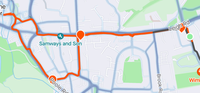

 same thing here. Fit bit tracking stops halfway through. Was tracking on Strava as well which shows the actual route I took. Strange I went for a run the other day and it worked perfectly.
So if you download the strave app for the watch, does it work ok through that all the time? is it just the fitbit excercise app that is broken?
Switching to Strava app on watch resulted in the same issue at the end of the run for me, no GPS data.
I tracked through Strava on my phone and Fitbit on my watch.
The Strava run was recorded via my phone with the Fitbit being done through the watch. Would point towards the watches GPS cutting out. Next time I run will keep an eye out to see when it loses signal.
