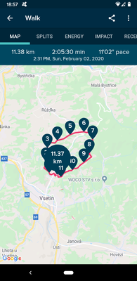

Heart rate is displayed ok in Autorecognized exercise and also ok when I Log previous exercise. But when I start Tracking all data is displayed except Heart rate - in fact essential data missing with Inspire HR. HW - Inspire HR, Pixel 3a with Android 10, app ver 3.13 (pls do not advise uninstall/install app, I did it twice). I think it is a bug.

Thanks Ricardo,
heart-rate reading and sync is working well. But see the attached picture, heart-rate is missing in the exercise record. I can see it correctly on Inspire and also in app in the Heart Rate section, here recorded correctly.

Hi,
any advice or bug correction concerning missing heart-rate in the exercise record - see attached picture in my previous replay,
