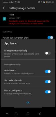

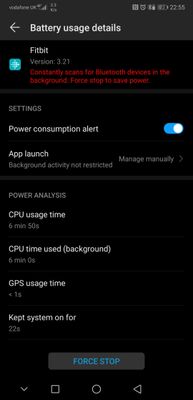

The devices are compatible. The problem lies with the phone and not the fitbit device you're using.
The p20 pro has very aggressive memory management which puts apps to sleep or users low power mode to conserve battery.
The fix is simple.
Go to settings.
Battery
App launch
Find fitbit and touch the blue button.
On the next screen, leave all 3 buttons blue.
It should now say Fitbit. Then below: Manage manually. The phone will no longer close the app allowing all day sync etc.
One further point is that the phone will occasionally say power intensive app etc. If this concerns you then to alleviate this, go to the fitbit app itself and turn off all day sync. Me, personally, I'm not bothered and leave it on.
Hope this helps and cleared up any future issues with huawei devices.
