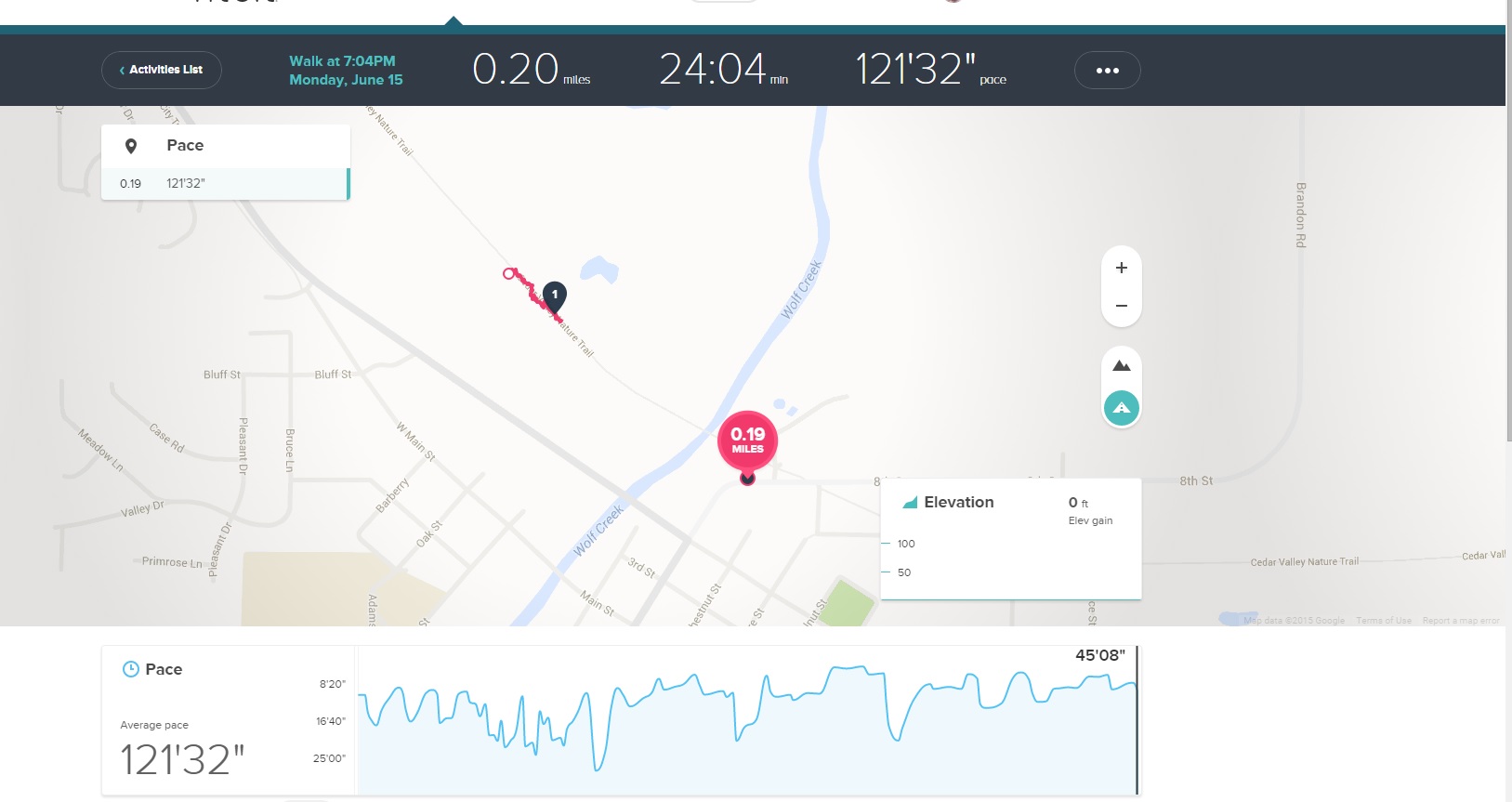

this is not a screen shot from my phone but is exactly what is happening to me. I found that it has been a issue in the past, so it worrisome that the issue is still there.

Hi there @gtorian, I'm sorry I haven't post anything recently lately. I've seen you share a screenshot but is not from your phone. In case the issue persist I would like to ask you a screenshot, but of your actual exercise to have a closer look and investigate better this situation.
