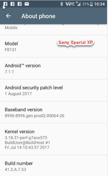

@JblancoWhat you are now experiencing is what most of us are posting in this topic. You can never pause and resume.. Only pause and Finish
What version of the App are you running ? and if it is the latest, and now has just started for you, the Fitbit Engineers have tweaked something and affected you..
What phone do you have...?
@PiLesleyhas success with version 2.42.
