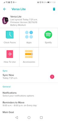

I have a constant alert symbol since the app update.

Hi @SineadD85 tap on the alert signal to see what it is alerting you to.

its telling me that my notifications are working, and i need to restart my phone.

Oh, I just did that there and disconnected the bluetooth. the alert is gone. Hopefully thats it now. Its such a pain
