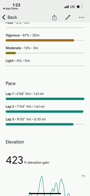

On Wednesday, following an update to the app, my walk showed the correct lap stats, i.e showing 1.0 miles:
The next day and ever since, it's back to showing 1.61 miles:
How did they manage that ??
