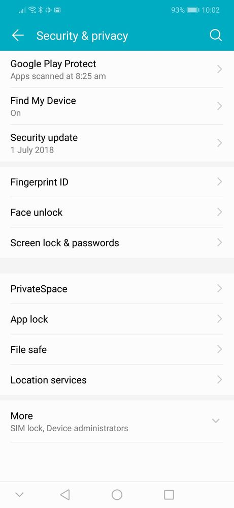

Go back to the main Settings page and select Security & Privacy
In there choose Location Services and click the 3 dots in the top right corner, click on Scan Settings
Uncheck the Bluetooth scanning option and go back out of settings.
