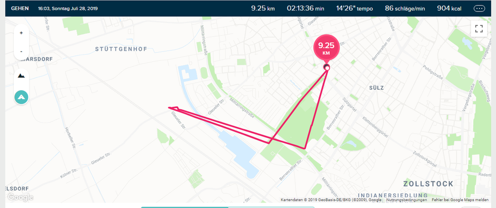

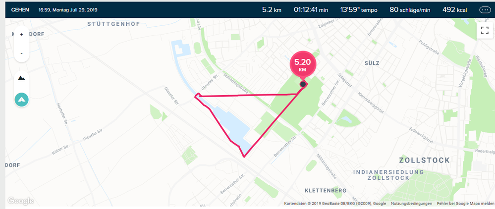

This is what my typical GPS tracks look like for over three months now. I can't believe you still haven't been able to fix it. @LanuzaFitbit , what can you tell us about any progress on fixing this problem? Please realize that at present your product must be considered simply broken like that. And this goes on for more than three months now. Are you serious? That's ridiculous and very embarrassing for Fitbit. And please, don't say your engineers are working on the issue. It just doesn't seem they do. I repeat myself: Very disappointing and poor performance. Please, at least have the decency to comment on the matter, @LanuzaFitbit (or anybody else who is in charge at Fitbit) ![]()
