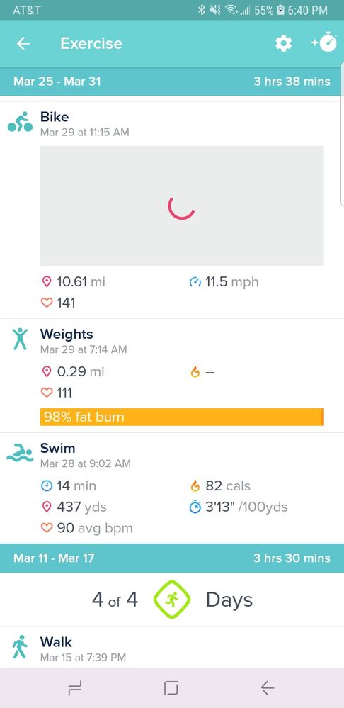

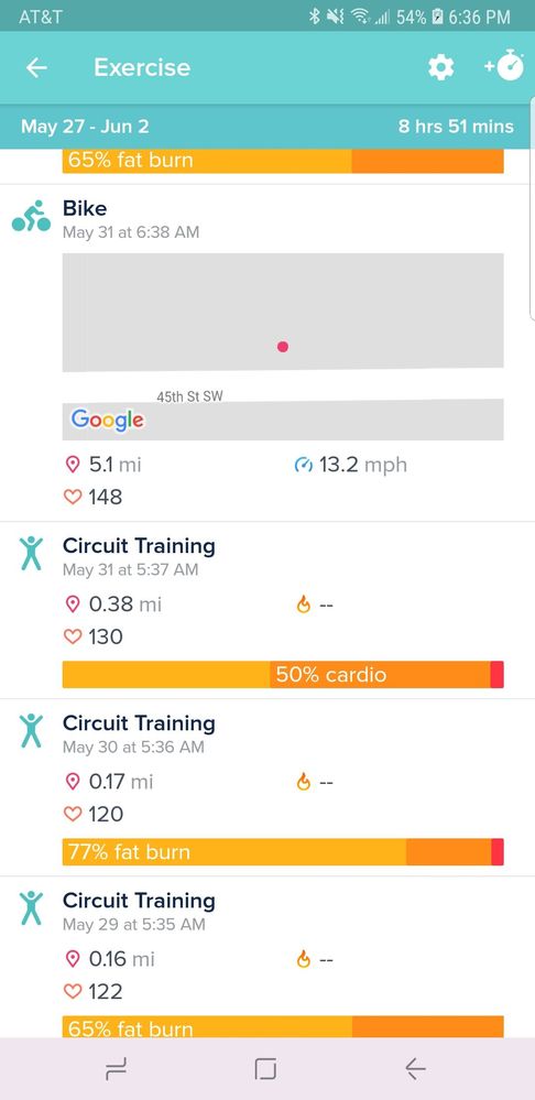

Second, there's so much GPS data missing from runs and biking activities in the app, but when I look online at my dashboard the fil and connect GPS map is there. Some activities the map will not ever load in the app, and all I have is the thinking circle. I don't get all the the data or exercise comparison when the maps won't show. I've talked to fitbit customer service several times and they can't help me. Here are some examples:

This map shows as just a dot in the app, but the full 5 mile path looks fine in my online dashboard
I have a dozen activities where the maps won't load at all. Again, they show fine in my online dashboard.

Now, for the mapp not loading or the map only shows a dot like you have demonstrated in the screenshots. Note that these are glitches that are already under investigation to roll a fix in the future. When the map keeps loading, most of the times is due to long exercises. However, so far I haven;t received additional updates regarding these issues.
