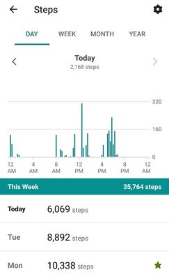

I have a fitbit luxe, bought last summer and use the fitbit app (what else) on my samsung galaxy s22 ultra.
in the last couple of weeks i noticed that the fitbit counts my steps as it should and it also syncs the steps in the app, at least the total steps. but when i want to check the diagram for the day, it has gaps. for example, i made lile 10k steps, and at least 2k of it in the evening but the diagramm doesnt show any steps in the evening. that happens multiple times a week.
but today for the first time, the diagramm showed no data at all but only a text saying "this diagramm has no data".
how? and why?

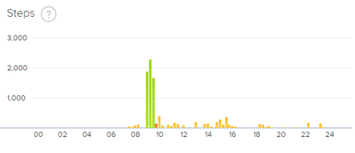

I'm experiencing the same issue and getting different counts on the daily step chart vs. the daily step list. Weekly view shows the correct total step count per day and so does the dashboard, but the daily activity graph is missing chunks of steps. See photo - today I had 8787 steps but the graph shows 4304:

Thanks for the suggestions. I followed your instructions to force stop the app and delete the cache. Still have mismatched counts but will check again tomorrow. The dashboard shows my steps with the total count from my device on both the step tile and detailed step graph:
Also wanted to add, the reason this is an issue for me is that I'm trying to export my steps to another app and it was seems to pull the lower count rather than the real step count.

I can confirm that it isn't a sync issue- force sync will change the total step number but not the number on the graph. If I go back to previous days, the graph counts are all missing steps. The only thing I can correlate with is that I started used a treadmill for part of the day. My fitbit device tracks these steps and adds them to my total, but they do not appear in the step graph. I just did 4000 steps on my treadmill and they are not on the graph at all. On days where I don't use the treadmill, the step count and graph count match. Is it possible that it's tracking my treadmill time as an activity and not adding those steps for some reason? The time/steps are not showing up in the activities list either.
