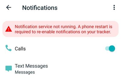

Notification service in the app is not working. I need to clear the data of the app and again log in, which clear the problem. But it appears again and again after few hours. There is no permanent solution to this.

@BhargavGajipara Welcome to the forums. I will gladly help you regarding the notification service.
Thanks for your initiative to solve this on your own. This is usually related to the settings on the device and permission of the Fitbit app. Which smartphone do you have?
I suggest you take a look at the following article: Why does the Fitbit app need to run in the background on my Android phone?. This other article has some helpful as well: Why are notifications delayed or missing?

Thank you for your reply. My am having RedMi note 10 pro.
Fitbit app has all the permission that possibility can have. But the notification service are frequently turned down. It means Versa 3 is just a fitness tracker not a smart watch.
