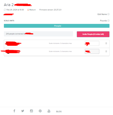

ARIA 2 Weighs only as Guest. HOW DO I REASSIGN?
I've tried EVERYTHING AND IT'S VERY FRUSTRATING. What should have been a 5minunte process has turned into an hour of frustration and i'm STILL GETTING NO WHERE.
You used to be able to assign guest weights quickly and easily. Now, you can't.
Online says Account>Devices>Aria 2>Assign icon to weight. Well, when you go to Devices>Aria 2, you're met with:
No weights to try to assign.
When you go to your dashboard, go to the weight section and click "see more" you're met with weights that have been logged, but that doesn't mean they're WEIGH-INS. I've manually logged my weight once in hopes that the scale would realise there's a manual weigh in at the same weight I now weigh and would give me the option to assign new weigh ins around that weight to myself AT the scale, but it doesn't. It still keeps saying "GUEST".
When using the app, you can go to Devices>Aria 2 and there is a "recent weigh-ins tab" (because why not make the app completely different from the website, right?...) but there is nothing there. No weigh ins at all. And from my memory of trying to fix this in the past, it's always been blank.
I've given myself a new icon, i've reconnected it to my WIFI, it syncs but no new weigh ins.
WHY IS THIS SO HARD.
