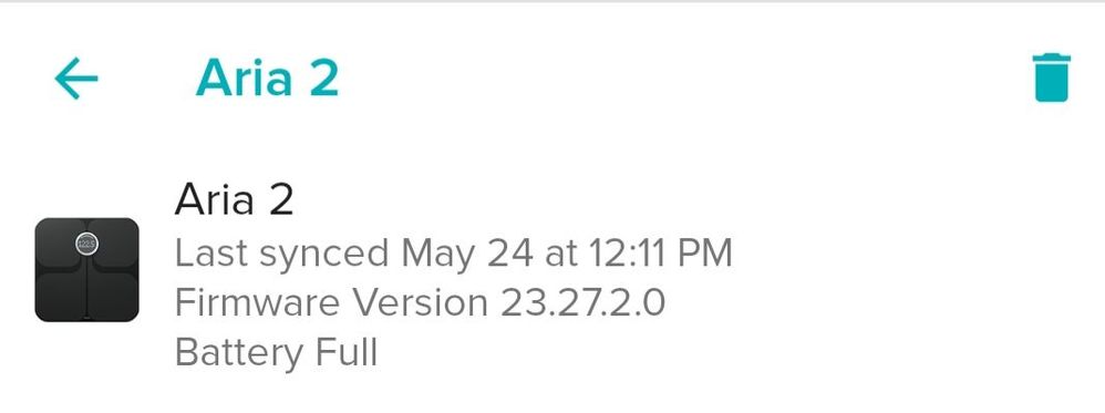

Last sync was May 24. 2019. Aria 2 will not connect to Fitbit App.  I removed batteries waiting several minutes (for 2 days now) following steps to try and connect. Nothing happens.  On 2 occasions I received a message "no Wifi" (something like that. I missed the 1st words but saw wifi). We do not have new router. We did not change anything

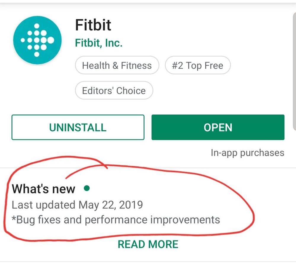

Attached are screenshots showing when my App last synced to the scale on May 24 and the App update done on May 22. It appears the App update done may have "broken" the Aria 2 connection to Wifi and the App. I only discovered the problem when I weighed myself after (I don't weigh every day but choose weekly).
