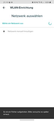

Hello,
i got a used Aria 2 as a present, it worked fine at the original owner.
I did a factory reset. And the scale says: www.fitbit.com/setup
Then tried to connect to it via the Fitbit App. It gives me the number wich i type in and then i get the same screen again saying "www.fitbit.com/setup".
I then saw my Scale in "My Devices" and tried to click on Wifi-Setup, pressed continue. It seemed to have found my Scale but always says an error message in a grey box at the bottom (no wifi or similar)
I tried with a notebook but it dosn't show me a network Aria Network i can connect to.
I also tried this with a different phone.
And changed my Wifi Settings to b+g+n.
Any Help?

I got all of that. But im not even coming to the point where i can choose the wifi, there i get this error.
It says: an error occured. Pls try again later. Also if i type in the bluetooth code my scale gives me, i get an error. So im not even able to choose my Wifi.

had the same and there is an easy fix the scales only work on the 2.4g wifi and some routers broardcast 2.4 AND 5G with the same SSID what you need to do is in your router split the wifi so the 2.4G is broadcasting on its own then set-up the scales from scratch and all will be good.
It took me ages to fault find this after my router did an update and the scales stopped working
