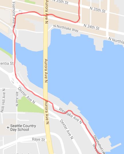

Just to pile on, I'm having the same problem with my Blaze overstating mileage while in connected GPS mode.
I run the same path each morning--roughly 4.8 miles to work.  When I leave the house, I launch the "run" exercise on my fitbit blaze, connecting it to my Samsung Galaxy S5 for GPS.  At the same time, I launch the MapMyFitness application on the phone.  I hit "begin" at the same time on the app and the Blaze and I get running.  Mile after mile, my Blaze slowly increases the measurement over the phone app.  But they are sharing the same GPS.  This happens every - single - day.  I get to work, my MapMyFitness app says 5.04 miles.  My Blaze and Fitbit app say 5.2 miles.  Consistently.
The only thing I can think is that these two systems (Blaze and MapMyFitness) samples GPS location at different intervals.  I've looked at the paths online and what I've noticed is that the Fitbit Blaze map is "jerkier"...less smooth.  Example--here is a segment from MapMyFitness:
And here is the same segement on Fitbit:
Notice the jerky path at Westlake right after Aurora on the Fitbit app--it's a smooth path on MapMyFitness (which how I actually run it).
I would love to hear from Fitbit how frequently the Blaze samples the GPS and how that impacts accuracy of mileage measurement.  I'm guessing that the MapMyFitness app is more accurate (it at least lines up with what Google says), but I would like to know for sure.
