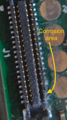

My blaze finally failed to turn on. I replaced the battery and it still failed to turn on. I opened the watch and started to look at each of the 3 ribbon cable tabs using a magnify glass. I found the largest tab to have corrosion at one end. Note the picture... If I had known this before I would have taken 90% or 99% isopropyl with a Q tip and tried to clean this area a year ago when I started to have charging issues ( perhaps with one wire from the battery disconnected and covered with tape). Now, its actually too damaged to clean or repair. Upon further investigation, I found that the original battery still had 3.5 volts. The new battery has 3.7 volts and still does. But this voltage is not on any of the four circular contacts inside the watch. I assume I should get a voltage reading on the 2 end contacts as I do get from the charger. It reads 5 volts. My suggestion is, before replacing a battery to check for corrosion and try to clean asap.
