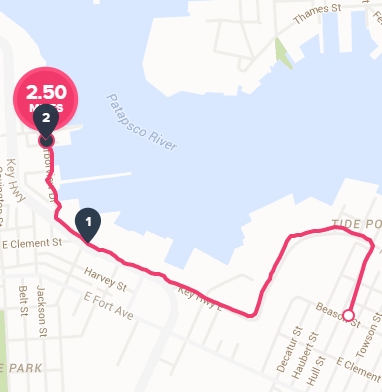

Hi @PKB76140 -- that is my guess too. This has happened once with my Blaze and iPhone 6 combination (notice no mile marker because the track shown is less than one mile).
I also agree with @EmersonFitbit to make sure your app remains open and running in the background for the entire execise and that if this continues it might be something to share with Customer Support so that they can look at the inner workings of your tracker. There also may be a need to update the Blaze or app code so that (when) GPS or bluetooth is lost, that the GPS track picks back up once the connection is reestablished.
