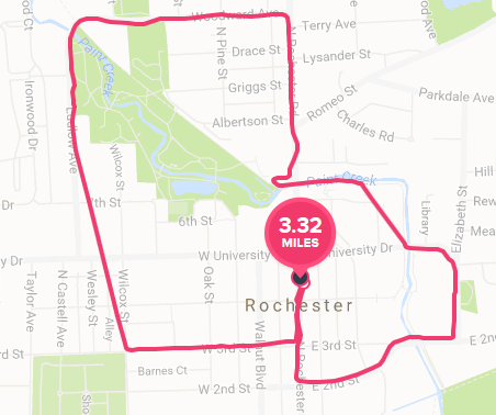

Using 'Run...', start with connected GPS with my Samsung Galaxy 4, midway through the run it stops tracking. When I finish my run, on my fitbit dashboard, I see the map is there, but it's incomplete. Did the Bluetooth get disconnected midway? How do I fix that? It's happened twice on long runs (over 30 minutes).
