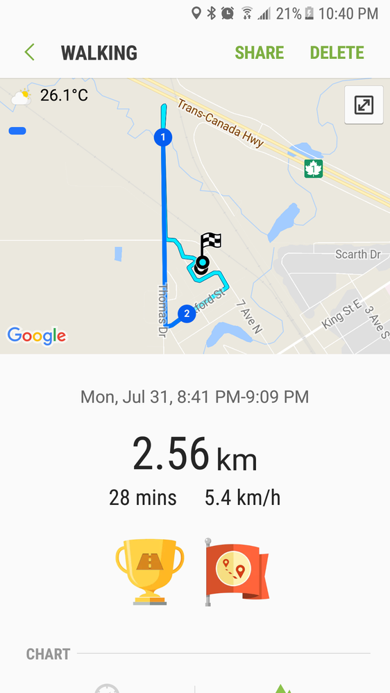

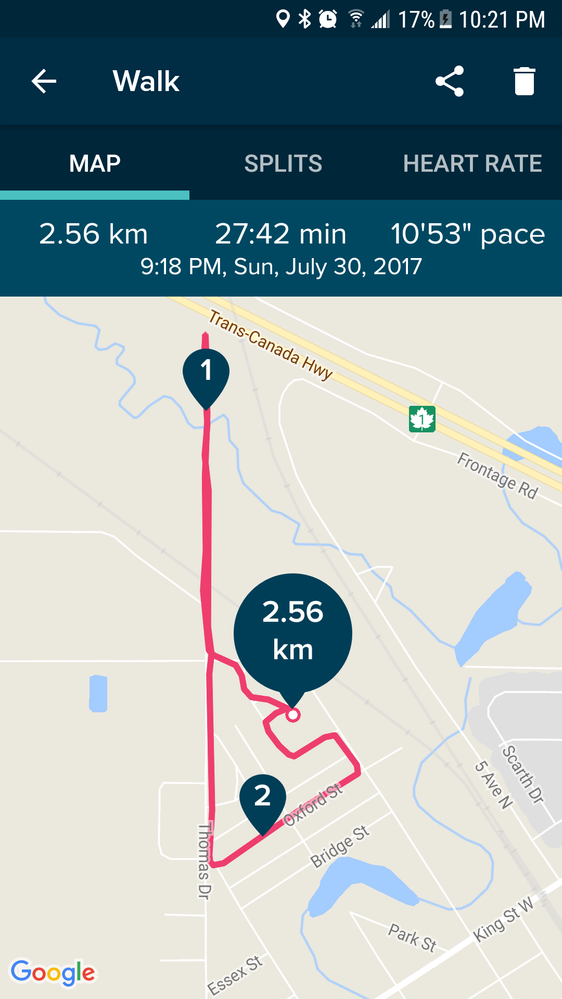

I'm finding the same thing.
First off I'm 6 ft tall making my stride around 75.5 cm (Fitbit has my auto stride at 75.9 cm) so in one mile I should take approximately 2100 steps.
Yesterday
From the app I started a gps walk. I registered 1.6 mi in 27 min 42 seconds and it told me I took 2100 steps. That would make my stride just over 4 ft at 120 cm. I probably took over 3300 steps to do that distance.
I emailed Fitbit with my frustration and was told just to use my watch for the steps.
Tonight I started a gps connected walk from my watch. I registered a 1.35 mi in 27 min and 29 seconds and it told me I took 2100 steps again. Making my stride 102 cm.
Then getting even more frustrated I walked it again logging it on S Health. It showed the 1.6 mi and 3372 steps in 28 min and 17 seconds. Giving me a stride length of 75.8 cm. Very close to my auto stride length. Fitbit didn't auto register the walk as didn't set anything on the watch or app but it did register around 2500 steps.
Don't know what to do but this is totally unacceptable to me.
