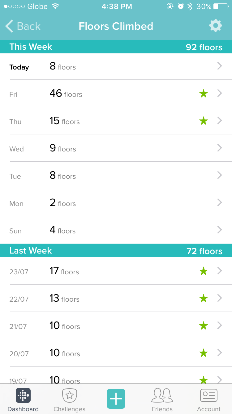

Hi,
Got my Blaze 2 weeks ago and all is doing fine until yesterday when it counted I climbed 46 floors! It was a typical day for me yesterday. Went off to work, climbed a normal amount of stairs, and I don't know why all of a sudden I got 46 floors! My normal would be 10-17. Yesterday was also a fine day, not windy or anything. Check this out.
Any idea? 🤔

Hey @FerdinandFitbit,
Just want to get back to you for an update. Actually, what I've noticed is when I ride a vehicle, the floor counts seemed to shoot up. I have observed this for 2 consecutive days. Like today, I rode a van and I checked the floor count in my Blaze. It says 13. Then when I get off, walked a bit, climbed a around 2 flight of stairs, rode an elevator going to sixth floor, I've noticed it went up to 30 floors! The other day I got 26 floor counts. I just restarted the tracker again. I know this is a minimal issue compared to others but I am kind of paranoid that something is wrong with my Blaze since this happened a week or two afer my purchase. The first week of use is actually stable and has a normal count. I would understand if the erroneous counting of floors happened from the very beginning, but it didn't.
Any advice? Thanks!

@Maddieee i won't answer for @FerdinandFitbit, but I think he will suggest a restart.
Just some thoughts on the way the Fitbit detects floors. It looks at a negative change in air pressure while it detects that your walking, you didn't mention the extra steps that was received during driving. Oh but your in a car, well fitbit has provided a way to remove both steps and floors.
So let's look at what might be happenning, a bumpy ride gives steps and an open window will reduce and or increase the air pressure in the vehicle, this will have an effect off adding floors.

@Maddieee wasn't trying to give an answer but to. I've an explanation of what is going on. As for DriveBit this is android only, iOS doesn't have a simaler app yet.
BTW every tracker on the market has this steps counted pro Ken while in a car with a stiff suspension or a bumpy road.
