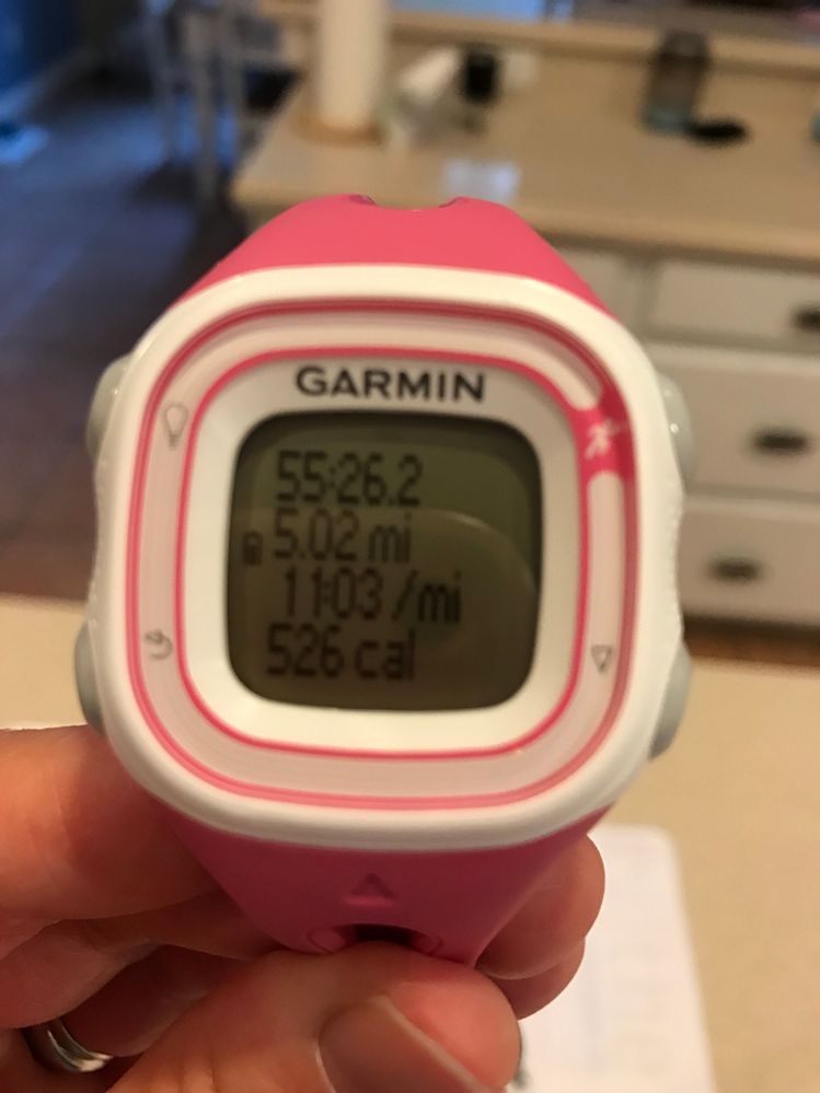

I'm so disappointed in the Blaze's GPS functionality, and I can't get any straight answers from customer service. The latest is that I was told to adjust my stride length but why should this matter when I'm using GPS?? Typical situation: went on a run this morning that I know to be 5 miles. Garmin watch spot on, Fitbit nearly a mile off. So frustrating!!

Thanks for your response! Yes, definitely connected to phone. Full bars. I am getting the map of where I ran, but distance way off. Thanks again.

I am fairly certain my run is actually 5 miles as I've tested it before. I'm sure that I don't always run completely straight (like a drunk - ha!) but it's just WAY too far off. Nearly 20% off in most cases. I should also add that Blaze majorly underestimates when I walk.
I do not set my stride length for running or walking. Blaze does it automatically. My best theory is that Blaze is periodically losing the GPS signal and it's filling in with stride length which overestimates distance for running and underestimates for walking. Both again about 20% off.

Blaze map looks normal. No strange routes. This is an older Garmin model so no maps. There could always be the possibility that the Garmin is off but it's been very aligned with past races that I have done (+1% at most) vs. Blaze said 27.84 for the Disney Marathon a few weeks ago +6%. Now seems more like +20%! I will try a third app or device tomorrow.
