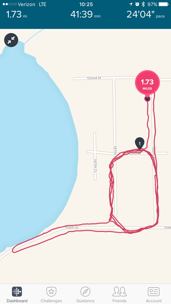

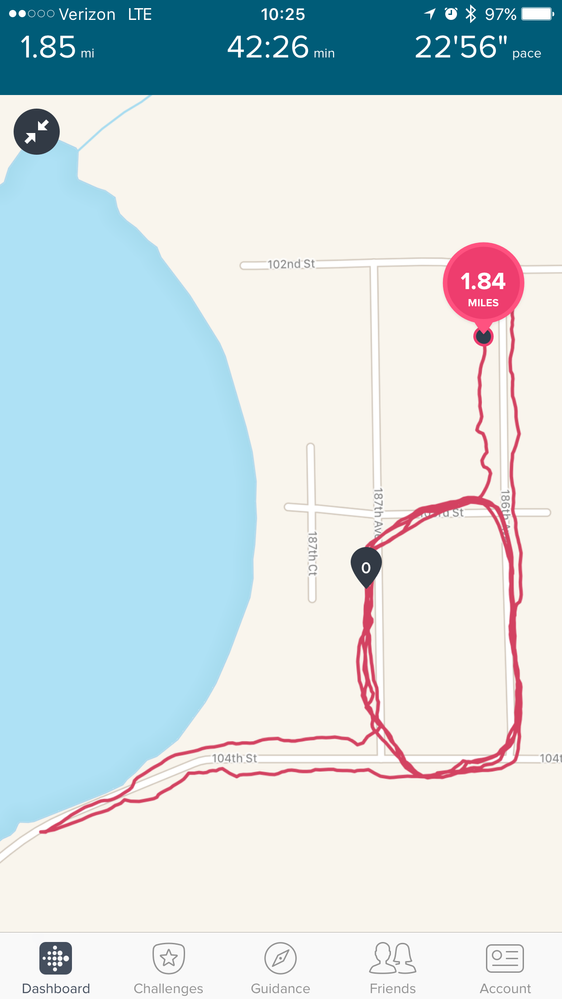

My blaze is horribly inaccurate and inconsistent. The exact same walk and not only is it different within itself, but it's also different between the blaze and my husband's Apple Watch, which IS consistent walk to walk. I've tried tracking via the watch (connected to the app) and also just tracking from the app itself. Those 2 situations also differ from each other given the exact same route. The screenshots attached are from walks with the exact same route (even so much as side of the street walked on). Any ideas or feedback?

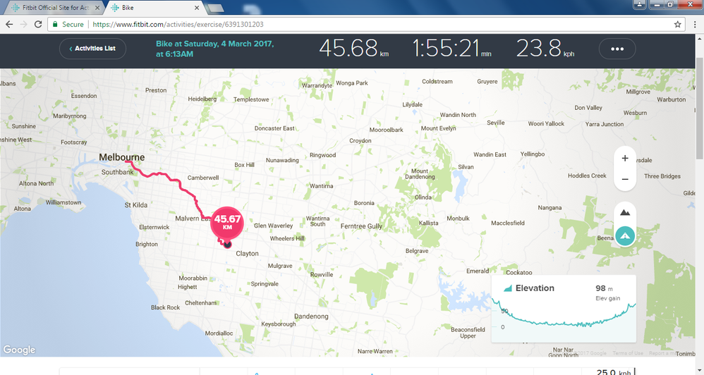

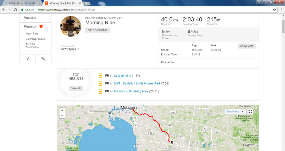

Hi @SilviaFitbit, As per you recommendation, I have restarted my Blaze and App on my phone for Saturday ride.
Fitbit shows 45km & Strava shows 40km which matches with Apple watch for same ride. Below are results. Strava results are transferred through Fitbit.

@rgajadaHi... It would be interesting to know how much of your bike ride was East/West. A couple of weeks ago I replicated the East/West issue that some of the Charge HR 2 Fitbitters are reporting. Breaking your GPS route down there appears to be about 15% of the journey in an E/W direction.
You finished near where I live....
North/South (N/S) is accurate. At exercise walking speed my East/West (E/W) route had the Fitbit distance increasing at the rate off 0.3m/second. I verified this with both of my Blazes and had a Surge in each test with its integrated GPS. These tests were individual N/S and E/W on flat pavement and no stoppages or dropouts on the GPS tracking. The tracking was perfect.. Just the calculation was in error for E/W
I could see there was going to be an issue because the Blaze had me walking consistently at a pace 2minutes/kmh faster on the E/W than the Surge. The Surge route was accurate and the Blaze was excessive by the 0.3m/sec or 30cm (12")/second.
Both the Surge and the Blaze's pace were within seconds of each other on the N/S route.
