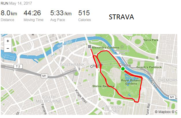

Best AnswerHi @AlejandraFitbit, Appreciate your response. Distance issues for me for Bike ride & Run.
I have raised my concern 4-5 months ago, all I got from Fitbit support team was “Sorry”… Also, I have posted my issue in Fitbit Forum @SilviaFitbit contacted has advised me to restart my Blaze and go back her if I still have problem and I never heard from her after posting my results on Fitbit Forum.
reading through the forums I am not the only one having issues with accuracy on distance. I really love Fitbit for it's features and simplicity. This issue might force me away from Fitbit.
I have spoken to Maria MD from support team on Tuesday night (Melbourne, Australia Time), waiting for response.
I have attached my latest run that I have participated with more than 5000 people which was 8km fun run and my clever fitbit records 8.95km.
Looking forward to hear from you & hope you can help me...
One thing puzzled me is 'How Fitbit can get away with reporting inaccuracy data....

Now welcome the Southern Hemisphere inaccuracy group. If you were using Connected GPS to your phone we have an East/West error where distance is accelerating at 30cm/second and about 2min/km pace gain. That is pure East/West.. North/South is OK. You effort has some East/West and plenty of diagonal.. Also proven in Chile...
The 1st image shows a small sample of a similar pattern I did at my Sports Oval in Murrumbeena.. Shows a 14 % increase on a measured track of 1.208 km with 1/3rd East /West the rest, similar to your map. When I wear the Surge, immediately I go in a pure East/West direction the pace on the Blaze accelerates by the 2 minutes/km and the Surge remains correct.
