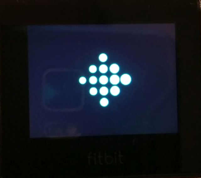

This morning i had to re-charge, i turned off the fitbit and put it in the charger. Since then it is stuck on the fitbit logo.

Try restarting it to see if that kicks it back into life:
"Press and hold the Back and Select buttons (left and bottom right) until you see the Fitbit logo on the screen. This should take less than 10 seconds."

Mine was doing the same. Holding the two buttons would make the logo flash once but never reboot. Placed into the charger connect to a wall plug... nothing.
Connected the charger to computer USB and it came back to life.
