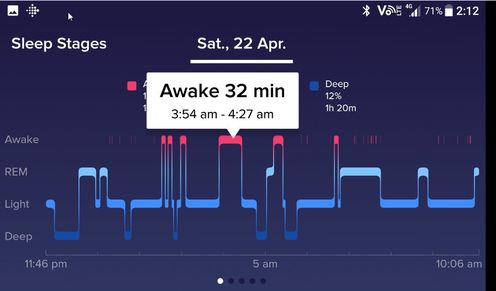

I have had 3 weeks of new Sleep Stages Graphs and last night the first few hours are old and the next few hours are new.
Deleted the logs and recreating as one I get the old Graph. Then deleting that and recreating with the original times I get the first as old and the second as new again.
I have submitted a report to Support including HR, steps and sleep graphs.

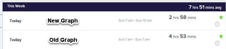

For sleep stages to show, the user must be asleep for 3 hours. If tor some reason a person gets up at night, and fitbit says that they are awake long enough to break the sleep into two periods. If the period is less than 3 hours, it will display the old graph.

@Rich_LaueI accept that, and here are the sleep graphs for last night.. and the new graph was 2 minutes under..

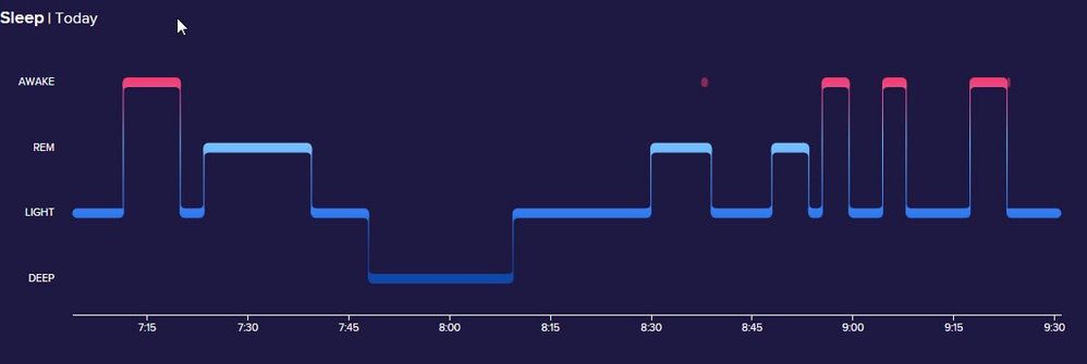

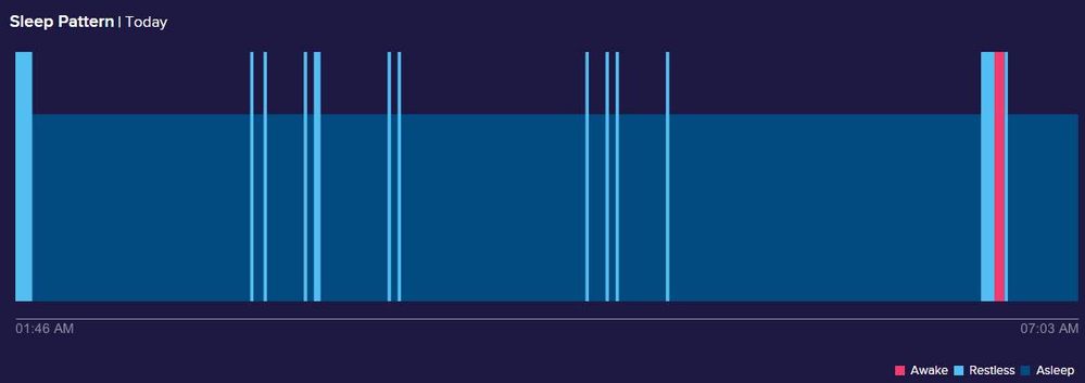

@WicTicI have successfully joined the less than 3 hour blocks by editing the sleep records..
For example deleting the fragmented old sleep graph and editing the remaining one and extend its time to the finish time of the deleted fragment or readjust the start time, depending on when the fragment occurred..It appears once the sleep tracking has the correct information it will revert.
You get this type of thing and it allows you to keep the statistics in perspective.
