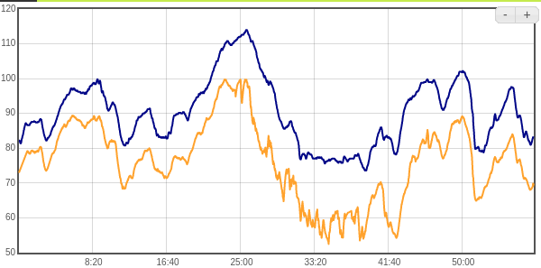

@Rambo80 it is easy to check. See (if you have any other Fitbit) the elevation of the run given by Fitbit and then upload the same route into Strava (Create Route tool) and see what elevation it's going to come up with. On top of that, there is no calibration of reference altitude. Example from Today, windy 12k run (data from Sense):
Orange - Fitbit raw elevation, Blue - Corrected with GPS dataOrange - Fitbit raw elevation, Blue - Corrected with GPS data
The reference altitude (see the offset between data points at the same timestamp) is never right (and for some reason, Fitbit never calibrates it).
The highest point (right after the 25min mark) is corrected to 114m (I double-checked it with the elevation finder on the FreeMapTools website which shows the same point as 113m - good enough). Fitbit at the same point shows an elevation of 100m. The lowest elevation in the area (whole area, not just the route, I narrowed down the radius to find the lowest elevation) of the run is 70m and Fitbit goes way below that. Also, the jagged orange line is like that due to wind and rapidly changing barometric pressure. It is not a matter of believing. It's a matter of looking at data.
