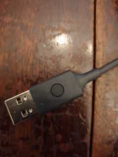

Hi, @rachel.estrin do you have the charging cable that came with your Charge 5? It should have a button on the USB end of the cable.
If you bought a third party charging cable it will probably be missing the button.
When the screen is frozen you need the button to reset. If your screen is not frozen or blank you can use the settings app on your Charge 5 to restart. On the clock screen swipe down until you come to settings and then swipe up until you come to restart.
