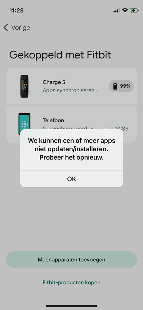

Okay I tried again this morning (29/09/2024), Connected the Fitbit to the charging cable. It gave a lil buzz as it should. And for a moment it should the Fitbit sigil. Then went dark again. I did the reset procedure, a buzz and this time the Fitbit sigil stayed on the screen. The iPhone however still cannot find the Fitbit. Waited an half an hour, nothing changed. Reset the fitbit again, the screen goes dark, but this time I was able to sync the Fitbit to my IPhone. However the screen remained dark. Only to flash the Fitbit sigil so now and then, teh screen remains dark, but it seems to sync again. The Fitbit seems to restart continuously only offering a short time to sync. So it is doing something but in it’s current state it is unusable for any sport activity.
New fact: the Fitbit app on my iPhone gave an error that Fitbit wasn’t’ able to install one or more apps. I do believe it is stuck in a loop.
Translation: we cannot update/insta;; one or more apps. Try again.
