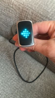

I’m so frustrated. I had an Inspire for a few years and loved it so much I decided to upgrade to Charge 5. Everything was OK until I went in the pool with it. And I’m talking wading, not even lap swimming. I sat in the water for maybe 15 minutes and my watch just died. All it does is flash the Fitbit logo on the screen, and the moment I try to reset it, it goes dark. No response whatsoever. I must say it happened about three months ago (I have had it for less than half a year) after showering, but back then I was able to restart it no prob. Again, I am so, so frustrated, because otherwise it was working just fine and I really loved it. What can I do? Sadly, I don’t have proof of purchase anymore 😞

I have done it all, and no, no vibration during restart, because it simply did not restart. Flashing logo on the screen and then goes black as soon as I try to restart. 😞
This is what I see, and it’s flashing.

Just back from swimming. The charge 5 lasted about 30min, went to check the time and found it to be unresponsive, black screen. Washed it with fresh water and now that I’m home I’ve placed it on charge. A few minutes later it was vibrating continuously, becoming annoying to the point my kids were wanting to destroy it 🙂 Did some googling and found out about the three press restart. This seemed to settle the vibrating down to a soft/weak continuous vibration and I now have the logo flashing. I’m not able to have it progress from this state. Contacted support and awaiting for there feedback.
