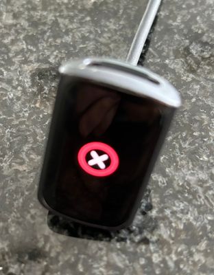

Charge 5 stuck on a red X
 what to do?
8 REPLIES 8
I have exactly the same issue, as usual my fitbit was working fine 2 days ago and then out of nowhere it crashed and started messing about and now it has the red circle with the cross in it
What is going on ?

Hi there, @AnnaKV. Welcome to the Fitbit Community Forums. Thanks for the image attached on your post, we're here to help you!
I agree with @Talahthas tips and recommendations, however, I'd recommend trying them in the order listed below:
  1. Complete the 3 pulse restart procedure method using the charging cable once again.
  2. Please sync your device in the Fitbit app by tapping your profile picture > Charge 5 > Sync Now.
  3. If you  can't sync, please try tapping on your profile picture > Charge 5 > Tile to see if the firmware banner appears (since a new firmware version has been released for the Charge 5).
  4. If it's still unresponsive, please try changing the clock face as well and check if you're able to see anything on the display.

Same thing happened to me.  It locked up at 7:16pm last night and gave me the black screen.  At some point it displayed a red circle with an X in the middle.  That has gone away and it's back to the black screen.  I done the three button push on the power cord three times and still nothing.  Yes, the power cord was plugged in and attached to the fitbit.  Yes, I waited one second between each push.    There has been some wonkiness with the fitbit over the past week or so and I believe it has reached it's EOL but I'm not sure.
I did that several times and nothing.  No screen, no more circle, just a black screen.  My Fitbit app says the phone as not been connected since 7:16pm last night which is about the time I noticed the screen go black.  The three button reset did notwork.
