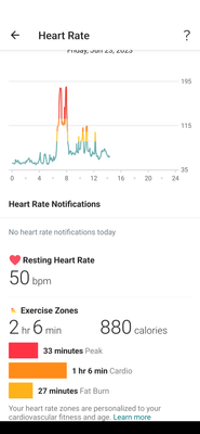

Hi, @papalock As mentioned the HR is disabled when you engage the "Swimming" exercise on your Charge 5. Next time you swim try using the auto-recognize function. Before you get in the water engage "Water lock" and just start swimming, the default is after 15 minutes it records your exercise as swimming (I find I lose the first pool length). On leaving the pool just go home & sync your phone, I always get HR under these circumstances.
This is my swim this morning -
I hope this helps but if you are still stuck please post here again.
