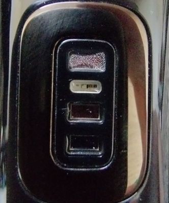

It's never been damaged and I've taken it swimming before with no issues. The attached photo can show the condensation in the sensor. The battery life was in the 75 to 85 range when I was swimming and I changed it after the first time it was in the rice and it went to 95 percent without any issues so I know it's not the battery. I've had it since December of 2022.
