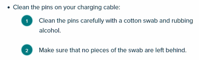

Could try cleaning pins on charging cable:
I have no idea if Fitbit would replace for that if still in warranty. If not, you could buy a new from the Fitbit store for $20, or get a set of 2 third-party chargers for < $10 from Amazon if the trouble is worth it to you.

@MaggieWise, in addition to the cleaning procedure that @JohnnyRow suggested, make sure that the pins on the charge cable are not "stuck". Both are spring-loaded, so when you press them down with your finger they should pop back up and sit proud of the plastic back by roughly 2mm. If one doesn't pop back up, wiggle it a bit with the tip of your finger and see if you can free it. If it stays down, your charge cable is defective.
