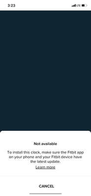

Unfortunately, none of that worked. This is the screen that shows up.

Hello @Rav-ioli
There was a firmware update for the Charge 5 which was supposed to include new watch faces. Apparently, the rollout for that firmware update seems to be currently on hold. It is frustrating to see the watch face and not be able to install it.
Hopefully, it won't be too much longer for another update to rollout.
I am also having this same issue.  I've tried the suggestions you've made MarreFitbit.  I have just had my charge 5 replaced because the display broke on my previous one.  I used to have the Brisk watch face, so I know it works but now I have received my replacement charge 5 I cannot get this installed.  It just says its not available.  So annoying.  What can I do?
